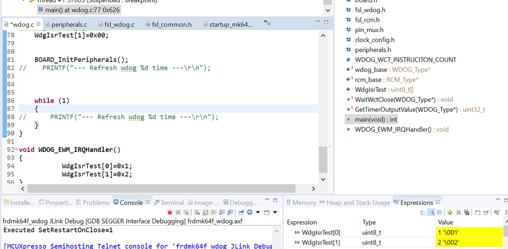

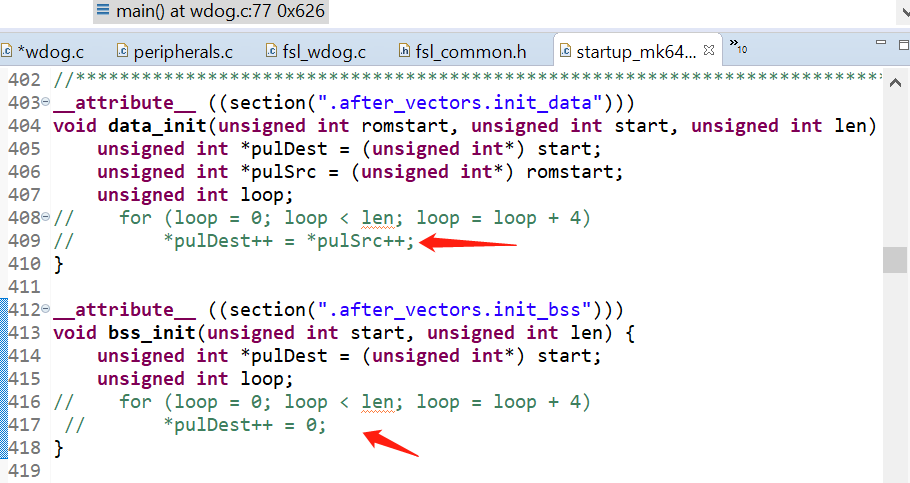

If your configuration is OK,you can set a val in handle to debug to watch if it is changed. But you need to avoid ram been inited after system reset.

https://community.nxp.com/message/939533
When I saw this answer, it was stored in RAM, so it seems that it is jumping to an interrupt. (It looks like the debugger is catching up).
So another question is, I want to record the stack to know where it came from. How should I use the assembler? Please let me know if you have a sample.
