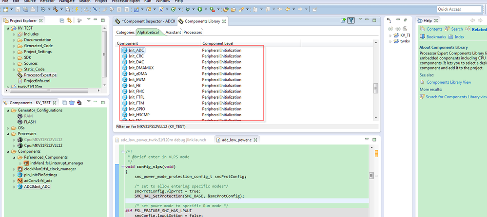

I'm working on a project using the TWR-KV31F120M. It seems that the processor and/or board are only currently supported with the KSDK, unlike the KV10 TWR board, which means that I'm stuck using the fsl Components in Processor Expert. So far the documentation I've been able to find on the fsl Components is far more limited in scope than the documentation available for "native" PEx Components. In particular, the documentation available for the PEx ADC component, particularly the usage examples, is far more helpful than the documentation for fsl_adc. The functions exposed by the "native" Components are also much more useful in getting things up and running quickly.
So far the only resource I've found for the fsl components are the html pages loaded by right-clicking on the Component and selecting "Help on Component". The code examples I've encountered all seem to ignore the fsl libraries, or are at least wrapping them in a higher level API if they are, in fact, depending on them.

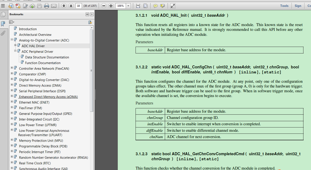

kerryzhou
Hi Lee shaver,
      My screenshotted is from KDS(Knietis design studio), actually KSDK is like  the sample code driver,  you can call the API function  directly,  you don't need to write the bottom driver by youself.
    You mentioned fsl_adc, that is still from our KSDK, it is API function lib, you just need to call it directly.
    Every function meaning in the module, you can refer to our Kinetis SDK API reference manual.pdf, just like the following picture:
After you install our KSDK, you will find the document in the path:C:\Freescale\KSDK_1.0.0\doc.
All the component from KSDK is high level,  if you want to see how to use it , you can refer to the example in this path:C:\Freescale\KSDK_1.0.0\demos
if you want to see the bottom code, you can use the peripheral initialization compnent in the KDS:
these components have the detail informtaion in the help on component.

leeshaver
Jingjing,
That support you screenshotted is from the KSDK and only has fsl Components available, as mentioned in my original post.

2,602 次查看
leeshaver
Hi Jingjing,
KDS alone (without the KSDK installed) does not support the TWR board, which was what I was trying to communicate. Once you install the KSDK to KDS it adds the board to the list that you screenshotted. While there is still a high level API exposed, it is fairly different from the KDS/PEx API that was available for the KV10.
Thank you for pointing out where the documentation for the KSDK is stored - it seems to be what I was looking for.

kerryzhou
Hi Lee shaver,
     KDS alone is supporting the KV31F512VLL12 now,  and KV31F512VLL12 is the MCU in the TWRKV31,you still can create a KDS project for it. You can just choose the peripheral initialization compnent which I already mentioned, that is not the high level.
But about other components, it is really different from the KDS that was available for the KV10, you should use the SDK components instead.
    SDK is the design trend for our new kinetis.
    About the document, just refer to the Kinetis SDK API reference manual.pdf.
    SDK also have some KDS examples for your reference.
