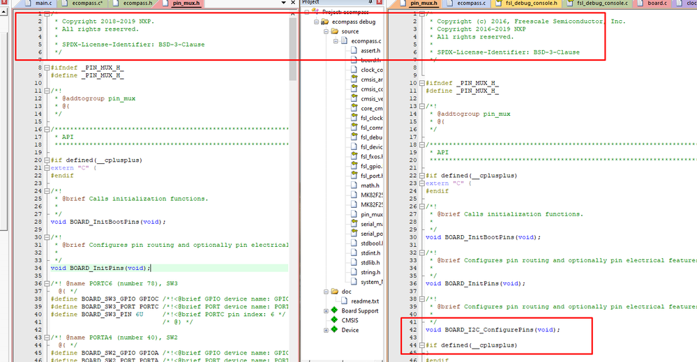

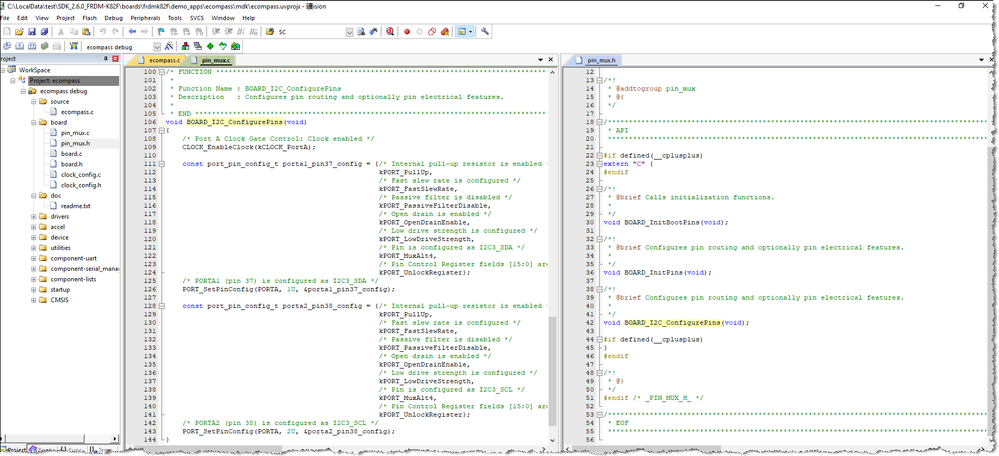

I'm trying to integrate the ecompass example from the K82F SDK as a module to a project I'm working on. I found out that some functions were being implicitly declared in my main function because they didn't exist in their headers. I then come to realize that the header's in the example are different that the one's in my project. One of these files is "pin_mux.h", and it's source "pin_mux.c".  So, I was wondering:
Why are there different version's of the same header?
Why doesn't the newer version have BOARD_I2C_ConfigurePins(void) function?
Is there a way to get the version used in the example?

Hi Miguel,
Customer can modify the "pin_mux.c" and "pin_mux.h" according to their needs.
I can see the BOARD_I2C_ConfigurePins(void) function in latest MCUXpresso SDK_2.6.0_FRDM-K82F.
