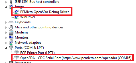

One way to determine if your board is working is using OpenSDA to load an application that communicates through UART and see if the board is responding.
  1. Download the OpenSDA drivers from http://www.pemicro.com/downloads/download_file.cfm?download_id=301 and install them
  2. Enter your board in Bootloader mode (see how using this guide http://cache.freescale.com/files/32bit/doc/user_guide/OPENSDAUG.pdf ). Drag and drop the DEBUG-APP_Pemicrov108.SDA file attached.
  3. Wait 10 seconds, then disconnect and reconnect the USB cable. Open the Device Manager. You should be able to see the following devices.      Untitled.png
  4. Annotate the COMM port number assigned to your device.
  5. Download and install CodeWarrior 10.6 from Freescale WebPage http://www.freescale.com/webapp/sps/site/prod_summary.jsp?code=CW-MCU10&fsrch=1&sr=4&pageNum=1
  6. Download the attached application to the microcontroller using CodeWarrior.
  7. Open a serial terminal emulation program (like RealTerm or Teraterm). Configure it to use the COMM port number obtained on step 4.
  8. Run the demo software on CodeWarrior. The characters written to the serial terminal emulation program will be echoed.
This will let us know if the Debugger and the MCU are working.
