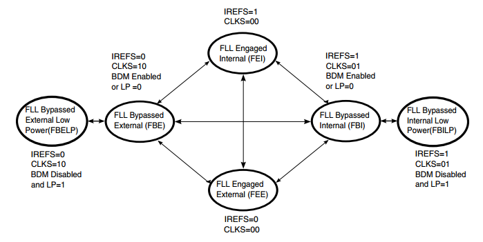

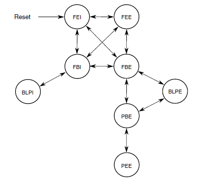

adriansc
For KL CW does not code this configuration, MCG comes out the reset in FEI (FLL Engaged Internal) mode (as Jim Donelson said) and you need to add code in order to change MCG modes. Check MCG mode state diagram:
It applies the same for S08 device: FEI is the default mode of operation for ICS; and CW does not code it.
