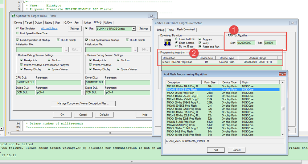

Dear list,
I am using ULIK2 debugger to flash/debug applications using Keil IDE for my TWR-K64F120M board. The "target driver setup" in Debug section project options was not detecting my board with default settings. After removing J39 Jumper, the TWR board was detected by the tool.
When I run the debug session or try to flash the application(default blinky project in the installation directory), I am seeing flash errors as in the attachment.
Is it possible to launch debug session with Ulink2 debugger with default jumper settings? If anyone has tried this combination(Ulink2, Keil IDE and TWR-K64F120M), request you to share the Jumper settings as I suspect that the problem lies in the jumper settings. The Ulink2 debugger is working fine as I am using it to flash and debug another Freescale K10 series mirco too.

Hi CSMG Sarma,
   I don't have the ULINK on my side, so I just test the external JLINK+TWR_K64F120M +MDK.
  From the keil website, ULINK should support K64 chip.
  Now answer your questions:
1. Is it possible to launch debug session with Ulink2 debugger with default jumper settings?
  No, you must remove the J39,  the default is connect the J39, this pin is connecting the SWD_CLK pin to the on board debugger.
If you want to use the external debugger, you need to remove J39.
Besides J39, please also connect J2 to power on the board.
2. You problem about :cannot load flash programming algorithm
Please check the algorithm on your configuration, the RAM for algorithm, and the Programming algorithm, the following picture is from my side:
I can download the blink project from the install path with external JLINK.
So, please check algorithm on your side at first.

Hi Kerry,
Thanks for the correction. I had removed this J39 connection already but forgot to mention this. Sorry.
Besides this J29 connected to 5-6.
With these connections made, the following sequence of target power ON has to be followed:
1. Poweroff target and Ulink2 debugger.
2. Connect Ulink2 to the Target board.
3. Power ON Ulink2 Debugger first.
4. Power ON target board.
Now the debugging and flash sessions are happening smoothly. Thanks for your suggestions. Full Marks :smileyhappy:
