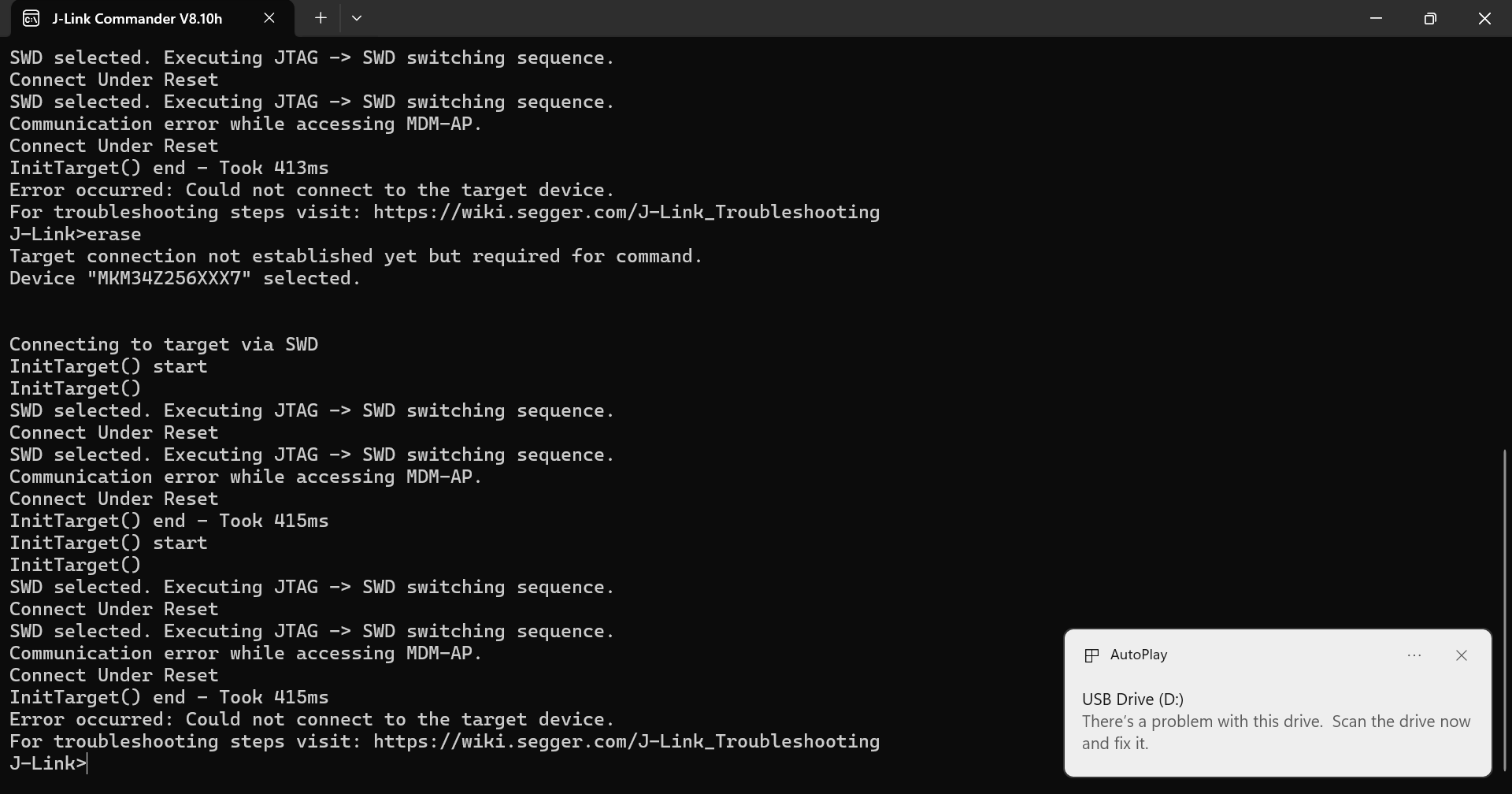

We also have a custom board that uses the KM35Z75M512 MCU (without an OpenSDA chip). It’s a completely virgin chip, and we use a J-Link device via the SWD header for flashing. The same issue is occurring on this board as well.
This issue seems to be very random in nature — sometimes it works, and other times the same setup fails without any clear pattern.

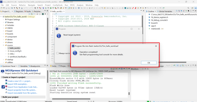

For reference, I’ve attached some pictures showing the problem.

The notification you are referring to is related to the pen drive (USB drive), which was connected at that time, so that notification is for the USB drive. As I had mentioned earlier, the screenshots I shared were taken while I was working on a customized board that didn’t have any OpenSDA chip. I was flashing the MCU using a direct J-Link hardware connection via the SWD interface. Also, the MCU chip was virgin (i.e., being flashed for the first time), yet I was still getting the same error.

I apologize for not noticing earlier. Screenshot 2 shows a custom board without OpenSDA. Now I understand.

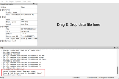

I tried with the TWR board. When connecting J-Link directly to the KM35 SWD without using OpenSDA, I still couldn't reproduce your issue.

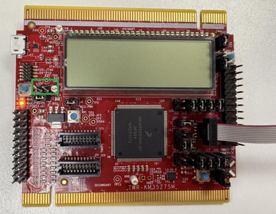

It should be noted that to connect an external debugger to the TWR-KM35, jumper J28 must be removed.
Here I attach my TWR board for your reference.

For the TWR board, could you please check whether the jumpers are correctly set? Additionally, would you mind verifying if the label on the back of your board says "REV A"?

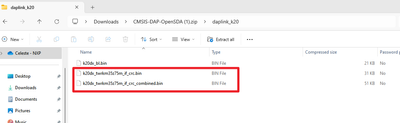

When your device mount with the name "maintenance", you need install the DAPLink interface application, just open the device's root directory then drag-and-drop the firmware update into this directory. The firmware is attached.
