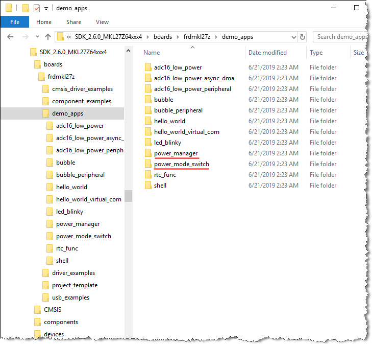

Hi Albert,
That Application Note use APIs of Kinetis software development kit (SDK). The KSDK is no more recommend for new design.
Please download the latest MCUXpresso SDK.
Then refer the power example in SDK_2.6.0_MKL27Z64xxx4.
Robin
