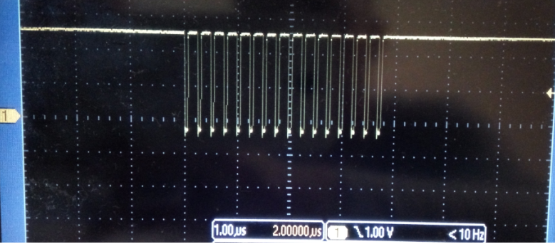

I use k10 to access sram. port size is 16bit. Data write and read is correct
BUT:  interval time between two access is too Long. so the performace of flexbus is very low
WHY??
Acess SRAM 16 times takes 16us,See the attachment picture

Please check the original code disassembly code.
You can set the compiler optimize level to enhance code execute speed.

Could you tried to use below code to do 16 times SRAM write (write to the same address 16 times)? How about the result?
void TestSram(void)
     unsigned int t;
     for(t=0;t<16;t++)
         *(volatile unsigned short*)(&SRAM_START_ADDRESS ) = 0x1234;
5,275件の閲覧回数
yangzeyong
Hi,Hui_Ma:
    The timing  writing to the same address 16 times looks normal,takes about 4us. Great Job!
    What's the problew of origin code?  Thank you!
