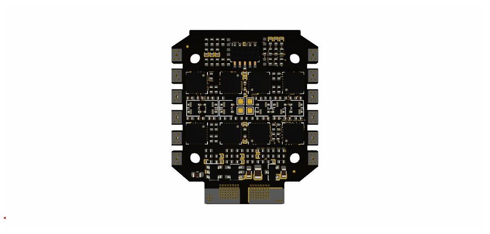

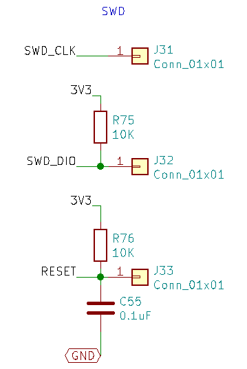

I have 4 KL05 in a board, Can I connect the SWD_CLK and RESET pins of the 4 mcus?

Hi Javier Hernandez,
   No, you can connect SWD_DIO and RESET together, but not the SWD_CLK, each chip should have the independent SWD_CLK, otherwise, you can't program it.

javierhernande1
Thank you
I have common RESET and SWD_DIO  pins in the 10pos. pin socket. and the 4 pads in the center of the board are the 4 SWD_CLK, one for each mcu.

kerryzhou
You are welcome!
 This design is OK to debug for each MCU.
