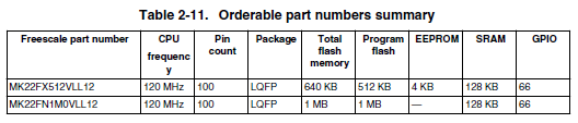

I have a problem in the MCU MK22FX512VLL12, the next document "K22 Sub-Family Reference Manual", mention that the memory SRAM is the size of 128 KB.

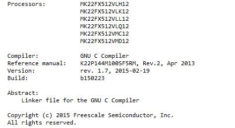

However, the linker file makes the next table. I am using Kinetis Desing Studio.
seems that this MCU only has a size of 64 KB in SRAM.
I am using the next version of the linker file
Someone, know why happen this?

Hi Emmanuel,
Yes, this problem is so strange. Please modify the link file to
m_data      (RW) : ORIGIN = 0x1FFF0000, LENGTH = 0x00010000
 m_data_2  (RW) : ORIGIN = 0x20000000, LENGTH = 0x00010000
Jing
