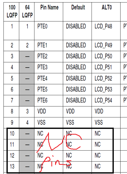

I would use MKL34Z64VLL4 with my next project. But there are some confusions about the pinout of it.
I download the datasheet of MKL34Z64VLL4 and the file of " MKL34Z64VLL4.bxl " from the site. But the pinout can't match with each other.
We can see from the pics I attached below,
#Pic 1 pinout of Datasheet
#Pic 2 pinout of .bxl file.
Can anybody give me a confirmation about it?

I think the datasheet is correct. For the MKL34Z64VLL4.bxl file you had download, I am pretty sure it is for KL46. Anyway, I should double confirm with design team and back to you if got any confirmation.
