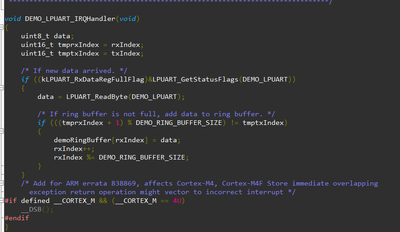

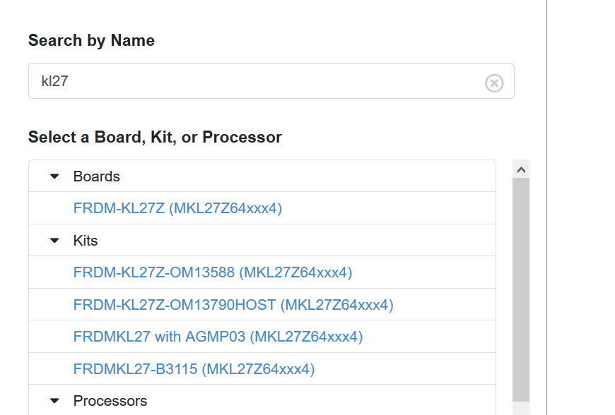

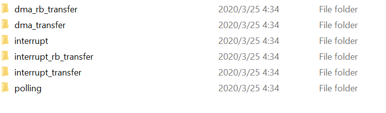

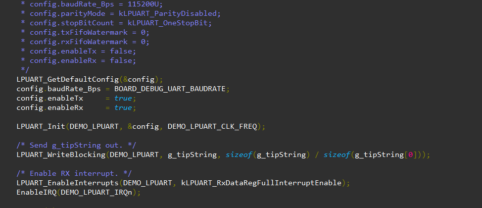

You can download KL27z SDK from this link,https://mcuxpresso.nxp.com/en/welcome.
And there has some uart examples in package.It explain how to configure uart and how to enable the interrupt .And also shows how handler function works.
