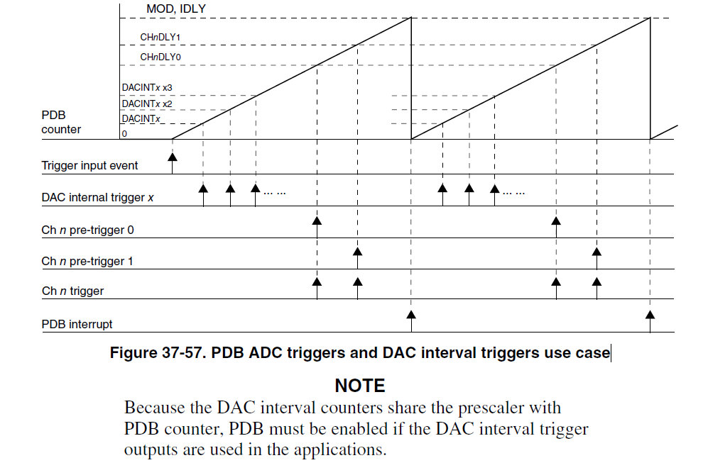

Referring to a similar K22F chip (MK22FN1M0AVLH12 -  K22P64M120SF5V2RM) there is a detailed description in section 37.4.3 including a diagram showing timing of DACINTx outputs (Figure 37-57).

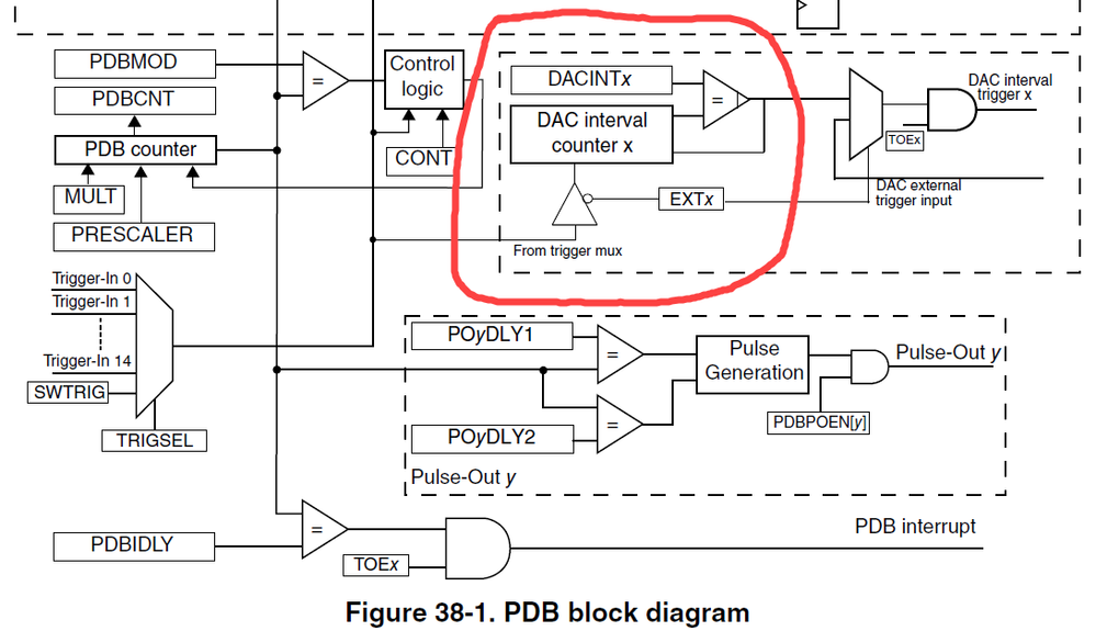

The description and timing diagram along with the block diagram Figure 37-1 clearly indicates that the DACINT triggers are based on a separate counter.  There is quite a lot of Freescale documentation that describes the PDB DACINT triggers as a comparison value against the main PDB counter rather than as a separate counter.

Quoting from the K22P64M120SF5V2RM manual (since this is missing from the actual manual for the chip being used): 37.4.3 DAC interval trigger outputs
"DAC interval counters are also reset when the PDB counter reaches the MOD register value; therefore, when the PDB counter rolls over to zero, the DAC interval counters starts anew."
When experimenting with the the PDB triggering and a DAC it appears that the DACINT counter is NOT reset when the main PDB counter rolls over.  It is only reset when a trigger occurs.  This seems consistent with the Block diagram Figure 37-1.  This means that effectively in free-running mode the DACINT trigger is unrelated to the the main PDB counter after the initial trigger.   This limits the usefulness somewhat.

You are right, the Fig 38-1 is correct, there is independent DAC interval counter, which can count the tick, the tick is the same as driving the PDB counter.

The figure you posted (and was quoted by me!) clearly shows the single  DACINTx value producing multiple DAC internal triggers - the third line of the figure.  These occur at multiples of the DACINTx value (DACINTx x1, x2 etc).
I have confirmed this occurs - I stated this in my question.  This is inconsistent with the DACINT being compared with the main PDB counter.  So the DAC sampling frequency is not determined by the PDB period unless the DACINT period is greater than 50% of the PDB counter value and an external trigger is used.
The block diagram from K22P121M120SF7RM shows a separate DAC interval counter with a reset signal coming from a comparator.  This appears to be a counter that runs from [0..DACINTx].  The operation of this circuit is consistent with the behaviour I have seen.
