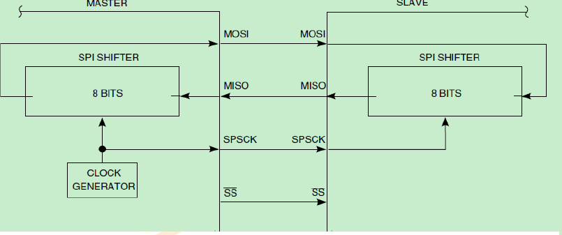

2. SPI connection
  Your connection is wrong.
Master   slave
MISO     MISO
MOSI     MOSI
SS        SS
CLK     CLK
You can't connect the MOSI in master to slave MISO,  you should connect MOSI in master to the MOSI in slave.

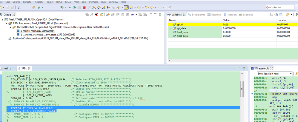

Slave:
1.  select the SSEL as the SPI select pin instead of just GPIO.
   SPI0_C1 &= ~SPI_C1_SSOE_MASK;
   SPI0_C2 |= SPI_C2_MODFEN_MASK;
2. enable the PTE0, PTE1,PTE2,PTE3 pull up for working stable.
PORT_PUE1 |= PORT_PUE1_PTEPE0_MASK | PORT_PUE1_PTEPE1_MASK|PORT_PUE1_PTEPE2_MASK|PORT_PUE1_PTEPE3_MASK;

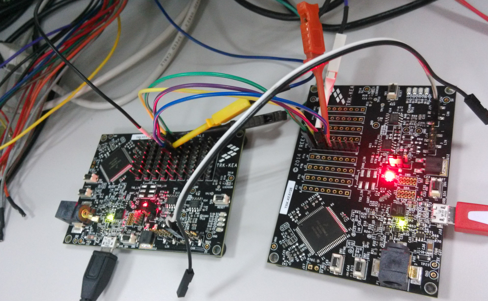

Then after connect two KEA128 together, it will work fine.
I have test your code on my TRK KEA128 board, it works ok.
Slave debug result:
Slave can receive the correct data 0x21 from master.

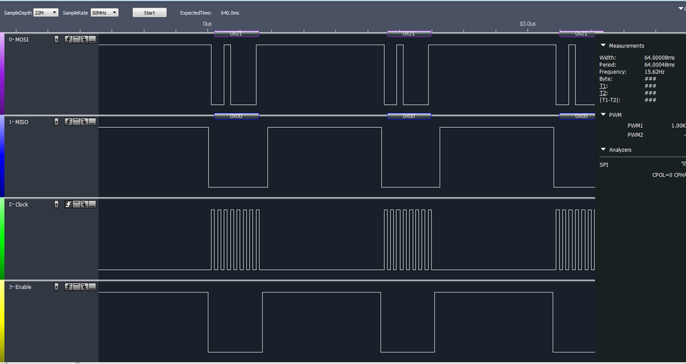

Logic analyzer wave:
I also attached my modified project for your reference.
