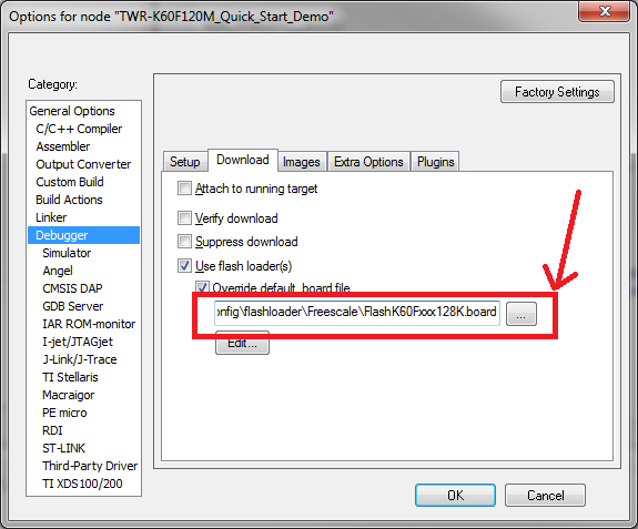

Further, at the advice of Need help getting started, programming through the debugger requires changing:
1,434 Views
thomasmurphy
Following Re: Can't build MQX 4.0 examples using IAR and my linked references.
Ensure dependencies are made first, in order: Rebuild All: bsp, psp, msf, rtcs, shell, usb_ddk, usb_hdk
Doing this required modifying all assembly '.s' files in each project such that every line beginning with "ASM_PUBLIC" has a space as the first character on the line. IAR will throw an error at every such line that requires editing, making the required edits easy to find.
In the Quick_Start_Demo project, add "$PROJ_DIR$\..\..\..\lib\twrk60f120m.iar\usb" to the C/C++ Compiler > Preprocessor > Additional Include Directories list and to the Assembler > Preprocessor > Additional Include Directories list.
From there, the project will compile successfully.
