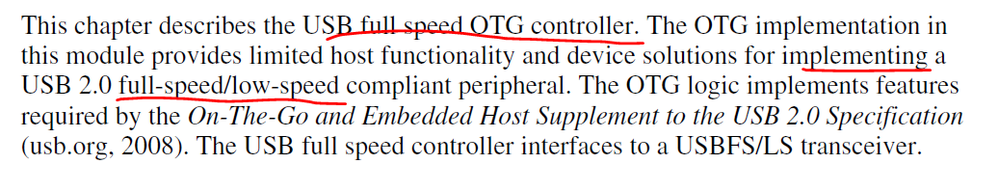

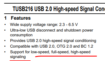

I want to know if the FRDM K64 which is using only full-speed USB could work with high-speed chips like the Texas instrument TUSB216RWBT.
If yes, will it be possible to increase the speed.

The K64 can only be used for low or full-speed USB device/host/OTG. To use it at high speed an external HS USB controller would be needed (eg. via SPI).
If your design needs HS USB operation it is simpler to move to the K65/K66 instead, which then allows one low/full speed OTG interface plus one low/full/high speed one.

1 Yes.
2 No. Full-speed and low speed.
