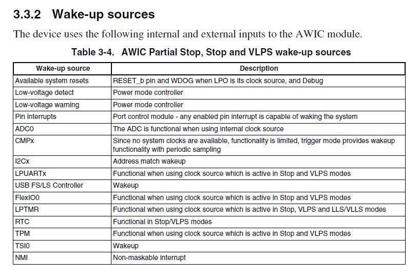

And the program doesn't get stuck after WFI() (line 219 of fsl.smc.c *1), so I'm guessing an interrupt is waking up the uC just after it has gone to sleep.

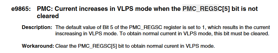

Please also be kindly noted that there is an errata related with VLPS for MKL82z128

The NVIC table is literally 0, all 32 possible interrupts are disabled.
So I have to asume one of these are generating an interrupt? If it's so, how could I know which one is triggering?
Thanks again for your help.
Edit: I think I've found what was 'instantly' waking up the mcu: the debugger. I have to prove this deeply (can't test currents atm), but I'm almost 90% sure was that...
