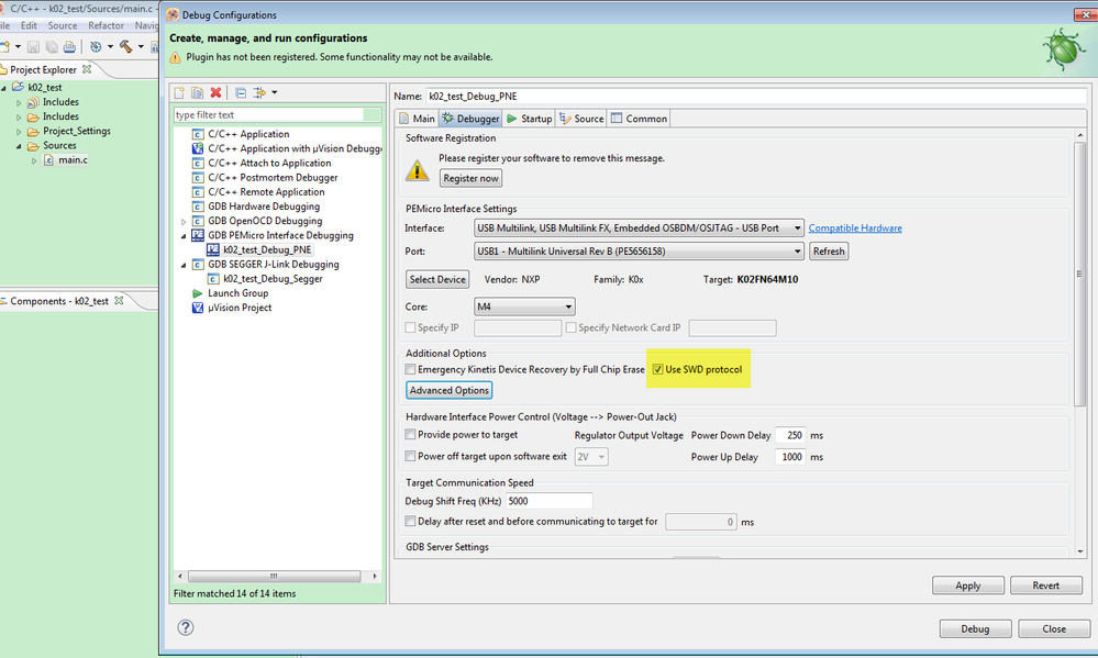

I do not know this interface.
Is it is present on USB Multilink universal PortF used for Kinetis?

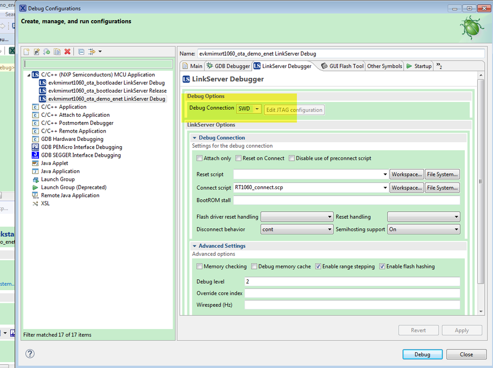

What is the difference on the using? On the MCUXpresso debugging interface?
How configure MCUXpresso to switch from the JTAG to SWD?

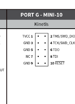

   Multilink can support the SWD directly.
Other port is the same, you just need to use the SWD_DIO, SWD_CLK, RESET, VCC and GND.
Kinetis chip related pin: PTA3 is SWD_DIO, PTA0 is SWD_CLK. RESET is your MCU RESETB.
About the MCUXPresso IDE, do you modify the JTAG debugger interface? If not, it should in default using the SWD.

  About the reset,  normally, we connect the MCU reset_b pin to the SWD interface.
  It means, the SWD interface have these signals: SWD_DIO, SWD_CLK, RESET_b, VDD and GND.
