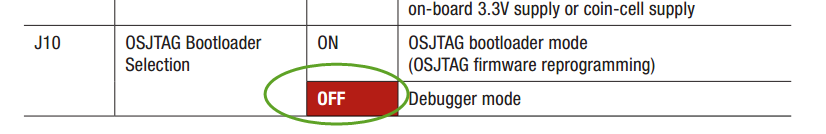

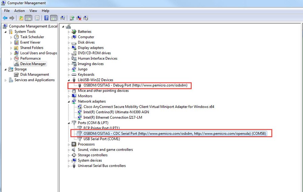

Customer need to remove J10 jumper to let P&E OSJTAG in debugger mode:
With the J10 OFF, customer could find below info from Windows device window:

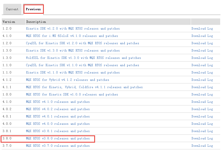

The demo is based on NXP MQX V3.8 software, customer need to download and install NXP MQX V3.8 software at first. The NXP MQX V3.8 software could be downloaded from here.

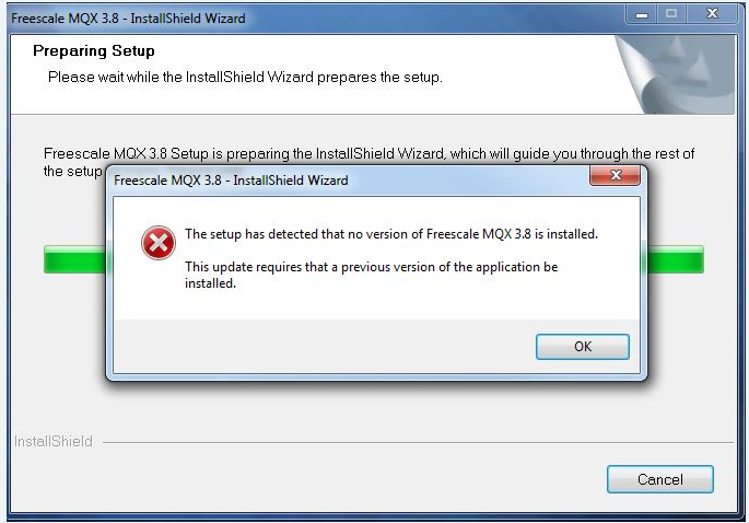

Also, when i tried to installed MQX 3.8 releases and patches above, it said that it previous version is not installed. i am not sure what's going on yet.  i installed MQX 4.2, but still the same message.

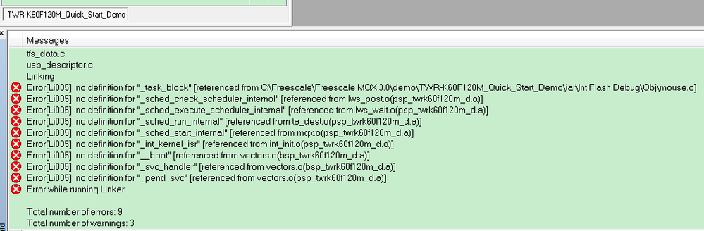

The TWR-K60F120M quick start demo is based on MQX old version V3.8 software.
So far, I am still get the compile error during build the  demo project:
The MQX installation issue caused by it need MQX V3.8 whole version software be installed before the patch installed.
I could not find the MQX V3.8 software from the website.
I need to check with MQX team if there with MQX V3.8 software available for downloading.
I will let you know later. Thank you for the patience.
