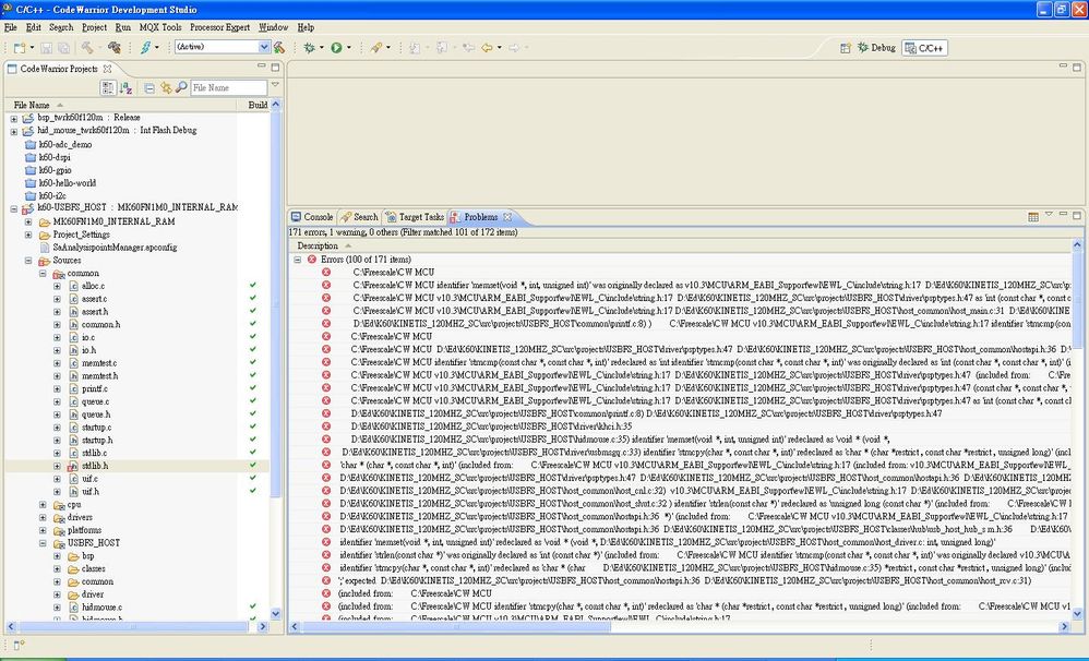

I try to compile USBFS_HOST in the KINETIS_120MHZ_SC, but occur many problem.
Can someone help me?

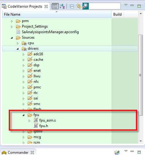

Hi Paul,
1> It need to set the CodeWarrior workspace directory to the "KINETIS_120MHZ_SC" folder location;
2> For fpu driver <fpu_asm.s> suitable for IAR compiler, which need to dis-select compile for <fpu.h> & <fpu_asm.s> files.
Please check below picture for more detailed info:
Wish it helps.
