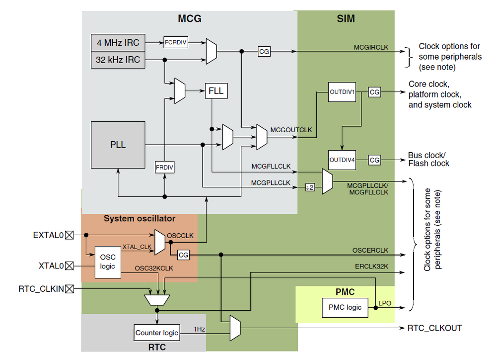

I want to operate mcu KL4x on a lower frequency than the normal 48MHz. Is it possible ?

Yes, it is possible. Are you using KL43 or KL46? These two devices have different clock module (MCG and MCG-lite). I recommend you the following link:
https://www.nxp.com/files-static/training_pdf/28973_S08_MCG_WBT.pdf
It is for MCG and it explains in detail the different clock modes. Actually, out of reset, Kinetis devices work in FEI mode which doesn't run to the 48MHz.

It includes a clock config tool where you can set the frequency that needs.

I am using KL46Z. Thanks for your help, much appreciated.

There are various clocking options:
See some references for the KL46 at
http://www.utasker.com/kinetis/FRDM-KL46Z.html
http://www.utasker.com/kinetis/TWR-KL46Z48M.html
including simulation of the operation and clock settings.
