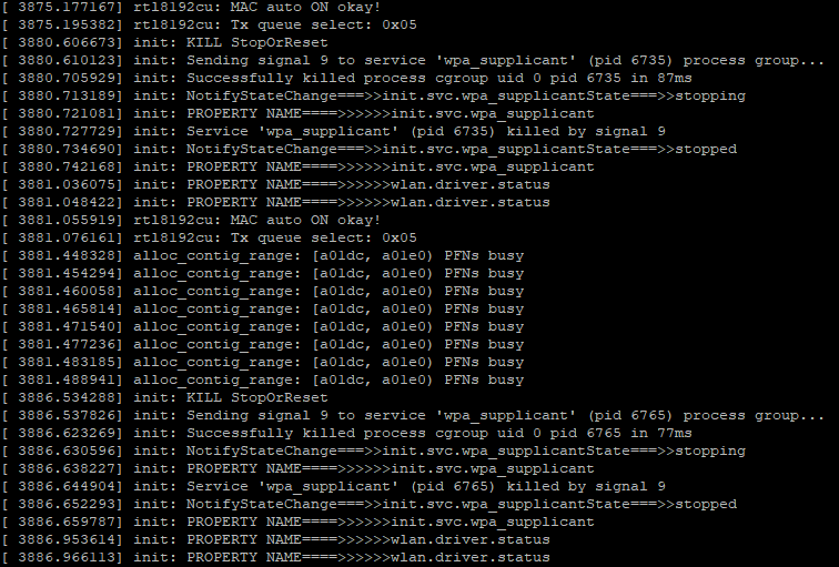

Hi, I`m working wireless interface on imx8evk.
I know there is a Atheros on the imx8evk to use wifi, but I want to replace a Atheros with a Realtek.
Currently, I install driver about rtl8192cu and check wlan0.
But, I had a problem when running wpa_supplicant.
Please refer to below the picture.
Sending signal 9 to service 'wpa_supplicant' is execute repeatedly.
No problem when I was running the command "iw wlan0 scan"
Worked with reference to Realtek Wi-Fi SDK for Android O 8.x ver. 1.0.1 and Android™ User's Guide, Rev. O8.1.0_1.3.0_8M, 04/2018.
How to solve this problem.
Thank you!!!

Hi woo
for "wpa_supplicant killed by signal 9" error one can look at
memory - what does "exited abnormally with signal 9: Killed: 9" mean - Stack Overflow
Seems this is severe error caused by wrong driver structure, for example due to
incompatibilty of kernel versions.
