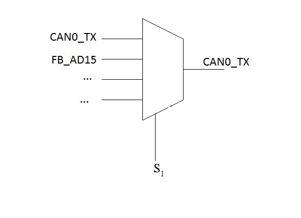

aureliengrange
Thanks for your answer.
As I need to use CAN with ENET and FlexBUS, I really need to assigned FB_AD[15-0] pin’s for other purpose than FlexBUS.
Assume I use multiplexed mode 32b address and 16b data.
On FB_AD[31-16] I will physically obtain 16b address and next 16 bits data (so like a 16b address/data multiplexed bus).
Pin PTB18 can be assigned to FB_AD15 or CAN0_TX (and others).
Does the CAN will work correctly if I assigned the pin PTB18 to CAN0_TX.
Or does the FlexBUS operation will disturb it (FlexBUS component is configured as 32b address and 16b data)?
If internally pinout multiplexing is like the picture below, even if FB_AD15 change of state, CAN0_TX should not be disturb. What do you think?
