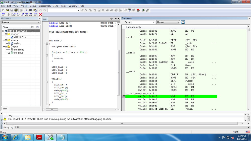

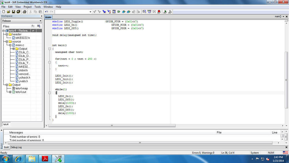

I am attaching some screen shots of my system,
i contains that i have success fully compiled the code,
second screenshot displays a function is DISASSEMBLY named __iar_program_start ,this is that code where my code revolves all the time and never go to main....
I have also follows the disassembly code of demo code ,
in that when i Press F5 code runs normally ,but when i go step by step it keeps revolving and never go to main,so iam unable to track which asm code or files are required tocall the main function from startup...
4,561 Views
jeremyzhou
Hi Ravindra,
Thanks for your reply. I'm glad to hear that you had compliled your project successful. However I've not figured out your new question so far and I think it should be related to the start function.
So I'd like to suggest that you'd better to choose the project which be creted by .exe and the project suit all KE02 miccontrollers. KE02 has been lauched since a year ago, so there's not many documents about it on net and I hope you could understand.

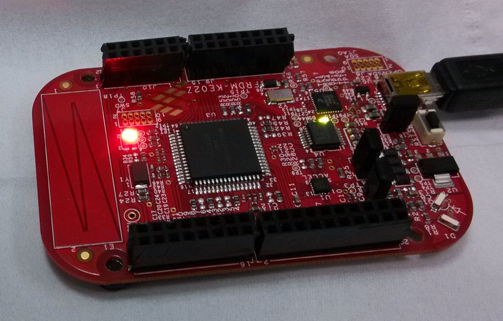

anyways Good news I have successfully runned A LED TOGGLE code on FRDM-KE02Z2 board without that .exe maken project,just added a .h file and disabled wachdog timer.
Thanx for you help ,But Problem dosen't stops here:smileylaugh: actually so many to come now,
i am trying UART1 cofigurations so that i can comuunicate with my PC and board(AS OpenSDA  degugger is connected with UART1 in board) it not running and it will also hang the debugger and my code (even led blink hangs..)
