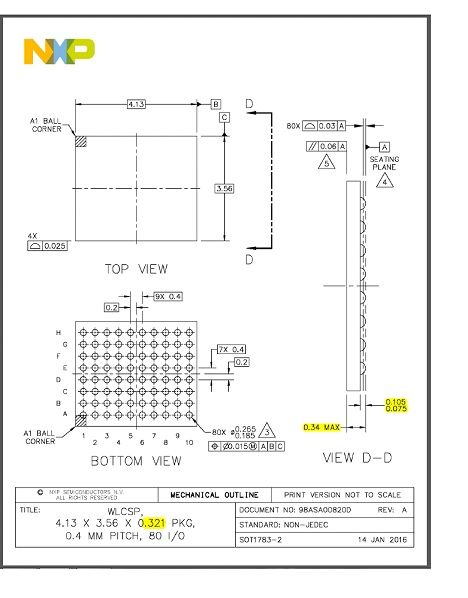

What is the NOMINAL die thickness and tolerance for this package?
The drawing is not clear if 75 and 105 are the min am max bump heights and 321 is the nominal die thickness?

vicentegomez
Hi dennis
Just to have it on the community
Nominal is: 0.321mm.
Max is: 0.340mm.
regards
