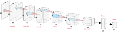

The network operation process is as shown in the figure
                            Figure 4
Conv2d-> convolution operation, Maxpool-> pooling.
The meaning of convolution operation is to extract the features of the image. Pooling is a bit like compressing data, which can reduce the running space.
28x28 input and output a 1x10 matrix, representing the possibility of 0-9

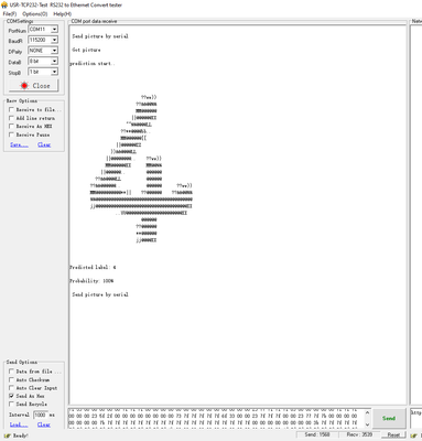

3.3 Then use pic2mnist.py(see the attachment), run this script with CMD and
enter 'Python pic2mnist.py 1. PNG ', 1. PNG is the image to be parsed, and then ‘content.txt’ will be generated. The file contains the data of the picture. Send the data to the MCU through the serial port. Note that ‘Send as Hex’ should be checked. Similarly, the handwritten picture will be displayed first, and then the picture will be recognized.
                                                        Figure 6
We can see that '4' was identified
