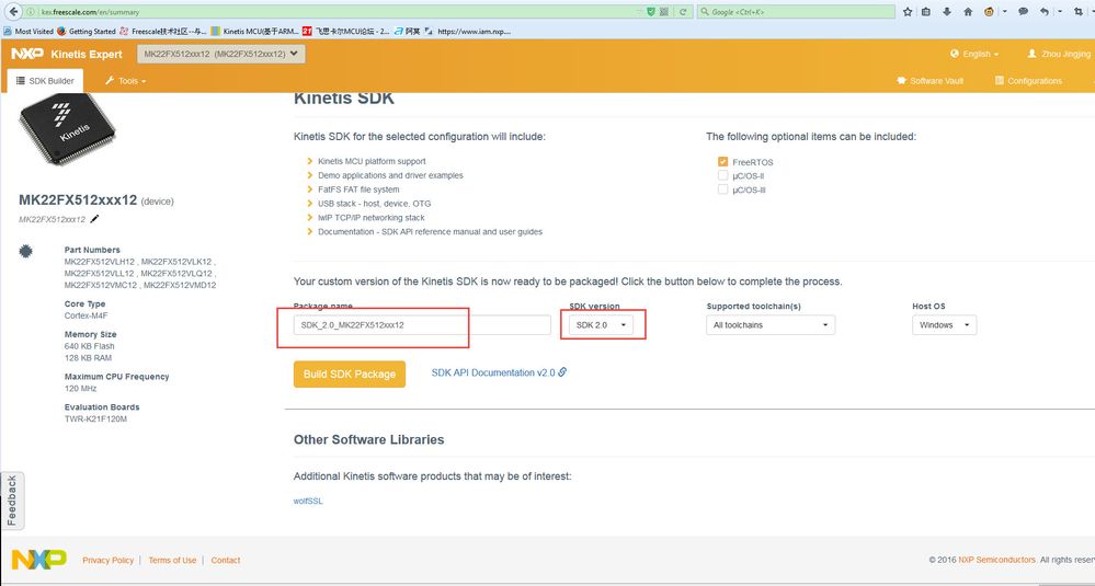

I am using KSDK version 1.3 and I have also downloaded KSDK 2.0 but I didn't know how to set it in the KDS as I couldn't find the file eclipse_update inside the tools folder. Please let me know how do I set it?
I am using PE Multilink Universal for debugging.
And, when I select MK22FX512xxx12 and download the file, the downloaded file is named as MK22FX512Axxx12, is there a difference between them?

kerryzhou
Hi Nakul,
    Did you download interface like this in the KSDK2.0?
If you are using the KSDK2.0, you don't need to add the eclipse_updated in the KDS, just open the KSDK2.0 kds project directly!
MK22FX512Axxx12 have a little difference to the MK22FX512xxx12, for details, you can compare the head file, there has some register difference.

Hi Jingjing,
Yes, that was how I downloaded but the website was automatically selecting MK22FX512Axxx12, but now I was able to download the MK22FX512xxx12 file. Thanks again.
