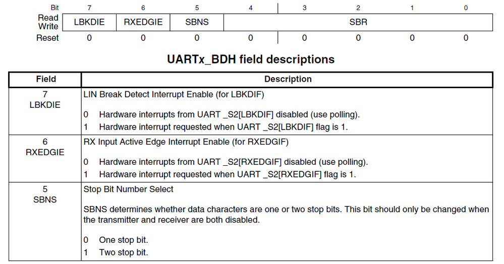

I'm looking at the MKL25Z4.H macros for UART0 Baud Rate Generation. The UART0_BDH_SBR(x) macro doesn't seem to take the upper five bits of x, but I believe it should. Is this a bug, am I misusing the macro, or is there a newer version of the file available?
#define UART0_BDH_SBR_MASK  0x1Fu
#define UART0_BDH_SBR_SHIFT 0
#define UART0_BDH_SBR_WIDTH 5
#define UART0_BDH_SBR(x)    (((uint8_t)(((uint8_t)(x))<<UART0_BDH_SBR_SHIFT))&UART0_BDH_SBR_MASK)‍‍‍‍

UART0_BDH has only 5 bits in the divisor and the last three are used for different functions:
The macro is masking the upper 3 bits (not upper 5) and is therefore OK.

Thanks, now it makes sense. The SHIFT and mask values are from the perspective of each register, rather than the value SBR which spans two registers. So the source code has to extract the upper byte of the desired SBR value before calling the macro.
