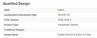

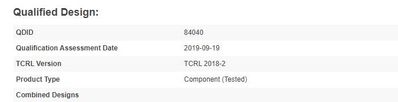

Hi @dcs_certif,
KW41Z QDIDs were renewed in Q3 2019 based on TCRL 2018-2, see below, you were probably looking at the initial listing date.
However, new TCRL can come with new ICS validation issues (not necessarily new mandatory tests). There’s no plan for NXP to renew the KW41 certifications based on TRCL 2020-1.
Is it possible that you could provide a list of ICS consistency errors based on TCRL 2020-1?
Do you use both controller and host QDIDs in their product?
Controller
https://launchstudio.bluetooth.com/ListingDetails/13631
Host
https://launchstudio.bluetooth.com/ListingDetails/13630

dcs_certif
Hello Mario,
Thanks for your feedback !
Yes, we are using QDIDs 84041 (host) and 84040 (controller).
I checked on Launch Studio, and these QDIDs are well updated (there is no last version, then as we created the project at the end of 2020, we have the last versions).

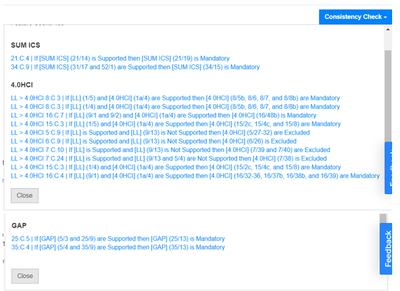

As ICS topic is very specific to BT protocol stack (then for specialist), I ‘ll try to sum up our BT consultant conclusion and our comments with colors…
New ICS
Supported in original NXP listing
SKF comments
Dependency Invalid
LL > 4.0HCI 15:C.3 | If [LL] (1/5) and [4.0HCI] (1a/4) are Supported then [4.0HCI] (15/2c, 15/4c, and 15/8) are Mandatory (15/2 and 15/4 previously supported, now 15/2c and 15/4c)
LL > 4.0HCI 15:C.3 | If [LL] (1/4) and [4.0HCI] (1a/4) are Supported then [4.0HCI] (15/2c, 15/4c, and 15/8) are Mandatory (15/2 and 15/4 previously supported now 15/2c and 15/4c)
LL > 4.0HCI 16:C.4 | If [LL] (9/1) and [4.0HCI] (1a/4) are Supported then [4.0HCI] (16/32-36, 16/37b, 16/38b, and 16/39) are Mandatory – new ICS added after original listing
LL > 4.0HCI 16:C.7 | If [LL] (9/1 and 9/2) and [4.0HCI] (1a/4) are Supported then [4.0HCI] (16/48b) is Mandatory – new ICS added after original listing
LL > 4.0HCI 5:C.9 | If [LL] is Supported and [LL] (9/13) is Not Supported then [4.0HCI] (5/27-32) are Excluded – can exclude now
LL > 4.0HCI 6:C.9 | If [LL] is Supported and [LL] (9/13) is Not Supported then [4.0HCI] (6/26) is Excluded – can exclude now
LL > 4.0HCI 7:C.10 | If [LL] is Supported and [LL] (9/13) is Not Supported then [4.0HCI] (7/39 and 7/40) are Excluded – can exclude now
LL > 4.0HCI 7:C.24 | If [LL] is Supported and [LL] (9/13 and 5/4) are Not Supported then [4.0HCI] (7/38) is Excluded – can exclude now
LL > 4.0HCI 8:C.3 | If [LL] (1/5) and [4.0HCI] (1a/4) are Supported then [4.0HCI] (8/5b, 8/6, 8/7, and 8/8b) are Mandatory – new ICS added after original listing (8/8 previously supported, now 8/8b)
LL > 4.0HCI 8:C.3 | If [LL] (1/4) and [4.0HCI] (1a/4) are Supported then [4.0HCI] (8/5b, 8/6, 8/7, and 8/8b) are Mandatory - new ICS added after original listing (8/8 previously supported, now 8/8b)
25:C.5 | If [GAP] (5/3 and 25/9) are Supported then [GAP] (25/13) is Mandatory – new ICS added after original listing
35:C.4 | If [GAP] (5/4 and 35/9) are Supported then [GAP] (35/13) is Mandatory– new ICS added after original listing
Any test cases triggered by new ICS will require additional test evidence, NXP would need to provide this by comparing their old Test Plan to a new one with ICS inconsistencies cleared.
Do you think that QDIDs from Q3/2019 (based on TCRL 2018-2) will solve these issues ?
If not, and assuming that NXP will not update KW41 certification, SKF will not pass BT SIG certification.
The next two are related to Core Erratum and need to be fixed.
34:C.9 | If [SUM ICS] (31/17 and 52/1) are Supported then [SUM ICS] (34/15) is Mandatory – this relates to Core Erratum 11838 Key Size Updates. Adopted 13 August 2019 (has to be implemented)
21:C.4 | If [SUM ICS] (21/14) is Supported then [SUM ICS] (21/19) is Mandatory – this relates to Core Erratum 11838 Key Size Updates. Adopted 13 August 2019 (has to be implemented)
Do you think that QDIDs from Q3/2019 (based on TCRL 2018-2) will solve these 2 issues ?
Thanks for your support !

mario_castaneda
Hi @dcs_certif,
We have created 2 new Bluetooth Launch Studio projects for controller and host, based on the existing QDIDs, and updated them to TCRL 2020-1. You could easily generate those on your end.
Please find my analysis below in purple.
Based on this analysis, NXP has to provide evidence only for 2 Host test cases that are related to core erratum 11838 (see attachment with the logs to be shared with the test house).
Could you please confirm that you are working with the KW41Z connectivity software - SDK 2.2.3 (MR4.1), Oct-2020, which includes a fix for erratum 11838.
New ICS
SKF comments
Dependency Invalid
  • [NXP] No new tests for additional ICS, and the feature is already supported in KW41Z
  • [NXP] Removed from Bluetooth Launch Studio project
Do you think that QDIDs from Q3/2019 (based on TCRL 2018-2) will solve these issues ?  If not, and assuming that NXP will not update KW41 certification, SKF will not pass BT SIG certification.
  • All new ICSes mentioned above should be checked in the product project based on TCRL 2020-1, they are supported and do now require additional test evidence.
Do you think that QDIDs from Q3/2019 (based on TCRL 2018-2) will solve these 2 issues ? If not, and assuming that NXP will not update KW41 certification, SKF will not pass BT SIG certification.
  • Only the Host ICS related to core erratum 11838 comes with additional testing: GAP/SEC/SEM/BI-09-C, GAP/SEC/SEM/BI-10-C. Attached new test evidences to be used for the current product certification based on TCRL 2020-1.
Mario
