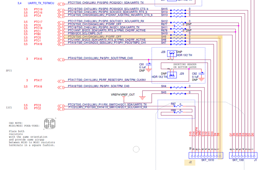

estephania_mart
Are you sure that the one you are looking for it's the PTA1 and not the PTC5?
Where are you seeing that label? And which type of shield are you using?
If you are using the Arduino pin compatible shield, I believe that you are using the wrong pin.
You can see in the schematic that the pin routed to the pin 1 of the J2 it's the PTC5.
Estephania

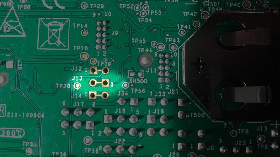

gerrikoio
When I do a continuity test with my multimeter, it shows that J13, as shown in the image, is connected to J2[pin 1] and in my MCUXpresso this GPIO is listed as PTA0. This also matches figure 2 in the Quick Start Guide for my board.
2,528 Views
estephania_mart
Which board version do you have? Could you please download the design files of the boards and compare it?
It seems to be a documentation issue of the Quick Start Guide.
Estephania

gerrikoio
On the board it says:
(700-29102) REV A2
(SCH-29102) REV A3
2,528 Views

gerrikoio
Not sure if I follow your logic.
Yes, I have tried pin config in MCUXpresso but because PTA0/PTA1 are also hardwired to OpenSDA SWD IO and CLK via J12/J13/J14 you cannot do anything with PTA0/PTA1.
So the only thing I could think of is to cut the traces on J12/J13/J14 and insert pin headers here are reroute SWD IO/CLK functions to other pins/ports etc. with wires. But this seems a large amount of work to do on the software side and I am not sure how you would do this easily.

estephania_mart
I checked the schematic version of the board you are using, and indeed it is one of the SWD pins, so in this case, you will need to use some hardware modifications to use your shield correctly.
Sorry for the inconveniences this might cause you.
