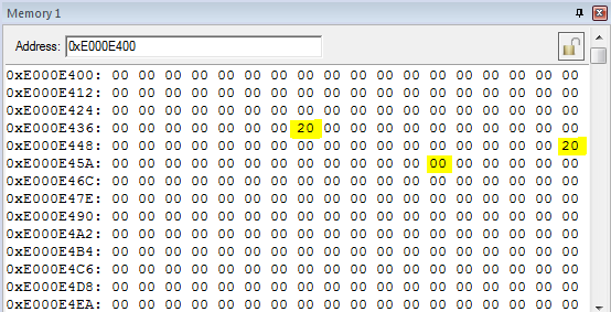

I am running a K20 72 MHz MCU on a prototype board we that have
developed. I have a UART interrupt and a PORTA GPIO pin interrupt. Both interrupts
are working well but they are Tail-Chaining. The application requires the PORTA
interrupt to preempt the UART interrupt. I have tried many NVICIP register settings
to no avail. Any help or hints greatly appreciated.

The K20 interrupts have 16 possible priorities and any pending interrupt with a higher priority than the one presently executing (as long as global interrupt haven't been disabled) will pre-empt.
Check that you are setting a higher priority (lower value) in the priority register in the NVIC.
Also check that you are setting the priority value correcty:
0x00 is highest priority
0x10
0x20
0x40
0xe0
0xf0 is lower priority.
Don't set 0x01..0x0f since these bits are not implemented and will read back 0 - it would mean that all interrupt have the same priority and so no preemption would ever occur (a common mistake of new users).

Hi Mark, thanks for your quick reply. I have read the information provided on the ARM Cortex M4 web site. I have also read through the K20 documentation. In short, set up looks pretty good.
The code below shows I have the priority set up with PORTA being the highest.
Address 0xE000E459 NVICIP61 USB = 0x20
Address 0xE000E43D NVICIP61 UART = 0x20
Address 0xE000E467 NVICIP103 PORTA = 0x00
I confirm this by looking both at the System Watch panel in the PE debugger and a memory watch window. (FIG 1)

Put simply - we can see that the blue is not preempting the yellow but holding off until the yellow is complete.
Is there something I must do in the interrupt routine of the UART to allow the PORTA interrupt to preempt?
One curious thing came across, in the debugger I could write a value to the NVICIP61 (UART) register and it would take it (say 0x30, 0x40 etc). This is not true for
the NVICIP103 (PORTA). If a value is written such as 0x30 it reads back as 0x00. I don't think this affects anything as I want NVICIP103 to be 0x00.
Again, any ideas would be helpfull. Thanks

Hey, I think I found it ... run the numbes on the address 0xE000E43D NVICIP61 UART. If I calculate the Address for the UART IP register I come up with E000-E42D NOT E43D. Checking the math/structure in the MK20D7.h file provided from freescale. I put 0x20 at the E42D address (in the debugger) and it now works!
Something is odd ... just have to find it.
1,903件の閲覧回数
davidgraham
Problem found ... being 0x10 off on the address triggered my brain! USE IRQ# not VECTOR#
So PORTA stauts IP register is NVICIP87 not 103 ... argh!
Working now !
