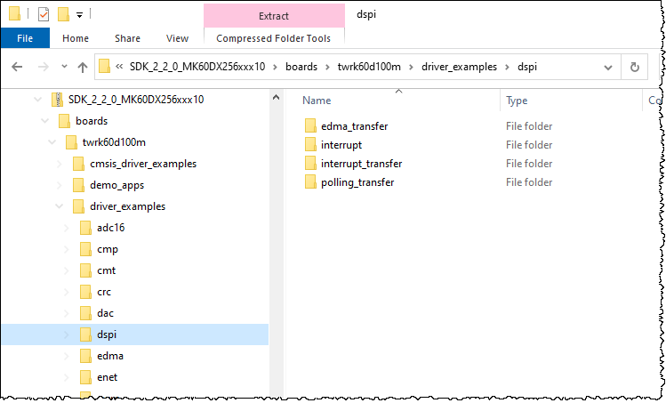

Robin_Shen
We do not have ADS8332 ADC example, but you can refer the spi examples in SDK_2_2_0_MK60DX256xxx10.

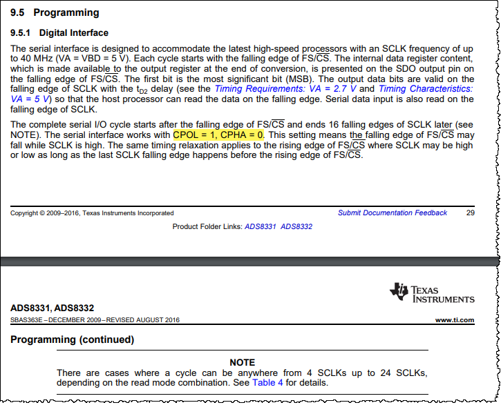

Please notice the setting of SPI:
