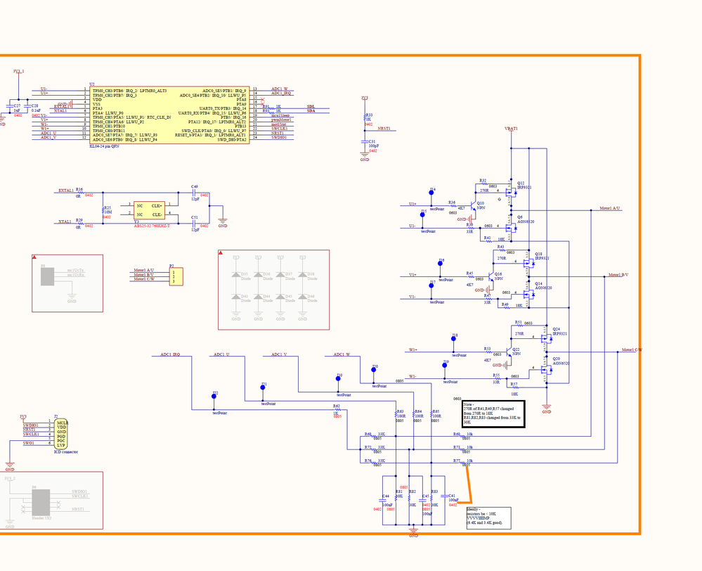

Hello ,
I am using the KL04 (24 pin package). The issue I am having is with the ADC of this chip. I am driving a motor and trying to measure the BEMF. The issue is with the ADC read of the BEMF. The voltage supplied is 8.5V. The VEFHH and VREFL are connected to the Vcc and GND in the 24 pin package. Also I have a LPF of 3K and 10K. So, effectively,  the 8.5V is stepped down to 1.96V.
So, VREFH = 3.3V and hence-forth for 10bit ADC will show 3FF for 3.3V. Which implies for 1.96V I shld get 260(hex). but end up getting 118. I don't think I am having too much impedance loaded up in my pi. The schematic is shown below
The code for ADC initialisation and read is as shown below -

why is this happening. Am I doing something wrong here.
