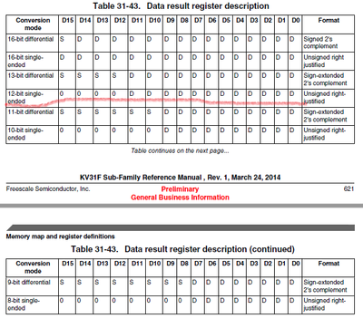

xiangjun_rong
Thank you for your answer
This program ADC value 950 range only varying KV31F512VLL12 IN 12 bit ADC why 950 range ?I`m using 12 bit ADC watch variable sample[0] only 950
PANDI
8,069件の閲覧回数
xiangjun_rong
You set the line:
DC0->CFG1 = ADC_CFG1_ADIV(4) | ADC_CFG1_MODE(1) | ADC_CFG1_ADICLK(0);
Mode bits is 01 in binary, so the ADC resolution is 12 bits.
The 3.3V full range is 0xFFF or 4095. The tested voltage on ADC channel is (950/4095)*3.3V=0.76V.
Hope it can help you
XiangJun Rong
