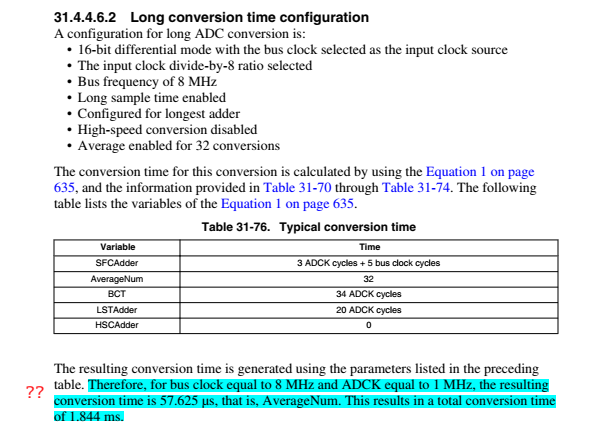

I am using Kinetis K12 device MK12DN512VLK5.
I have few doubts regarding the ADC conversion time calculations given in the reference manual.

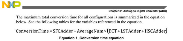

The reference manual provides the below formula for calculating the conversion time:
I understand that the above formula gives the total time for conversion and takes into account the
  • sampling time,
  • ADC conversion time as well as the
  • time required for averaging if that is selected.
Is my understanding correct?
My doubt arises because of the example time calculation shown in the reference manual:
My calculation for the above example (based on the formula given in the reference manual) comes to 1731.625 micro-seconds.
time = "3 ADCK cycles" + "5 bus clock cycles" + (32 x "34+20 ADCK cycles" )
ADCK clock cycle time is 1.000 uSec ( from ADCk freq. = 8 MHz/8 )
Bus  clock cycle time is 0.125 uSec ( from 8 Mhz bus clock frequency)
I am misunderstanding something or is this an issue in the reference manual?

nxf56274
The document has some mistakes. Your calculation is right.
