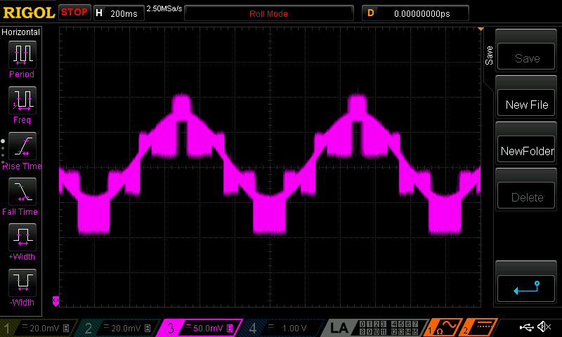

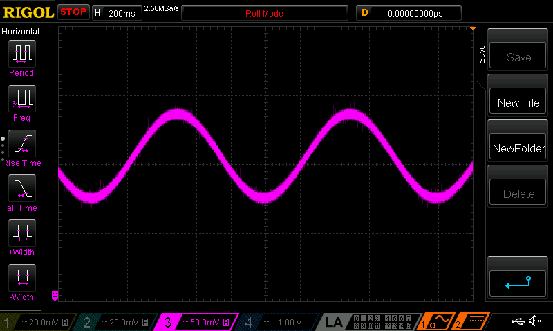

The left figure shows the input signal, and the right is also an input signal to K22 while ADC is running.
More interestingly,
The left figure shows the signal when all values on calibration registers were default value (ADCx_CLP0 = 32, ADCx_CLP1 = 64, ADCx_CLP2 = 128...). It clearly shows that the charging current to S/H capacitor depends on the values written to ADC calibration register, and finally, I found I could minimize charging current by writing zeros to all calibration register except ADCx_PG/MG remains 0x8000 (right figure).

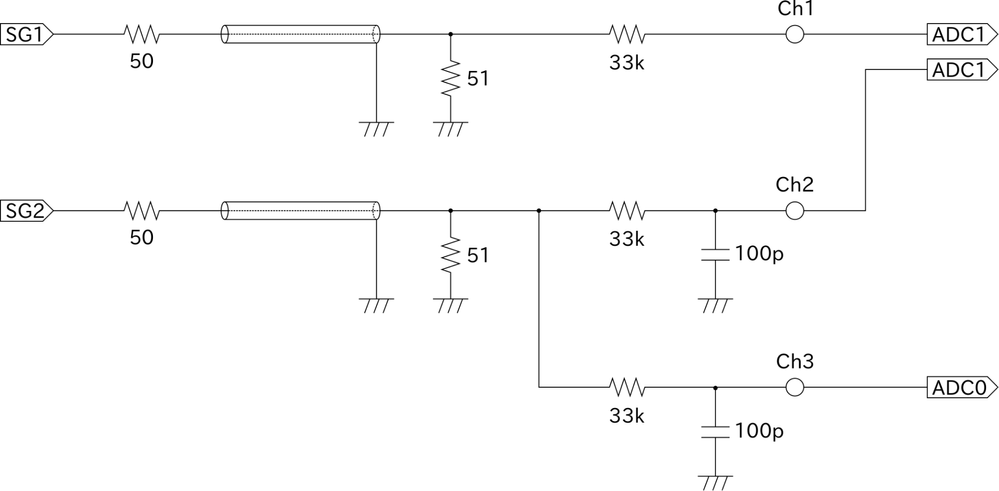

To visualize this problem, I've setup bread board as follows;pastedImage_5.png
Here, ADC1 interleaves signal from signal generator ch1/2 (SG1/2) in the order ch1, ch1, ch2, ch2. The signal from SG2 is shared with ADC0/1. Please note that, R/C constants are different from out production board, because the purpose of this setup is not to reproduce the problem, but visualize the problem.

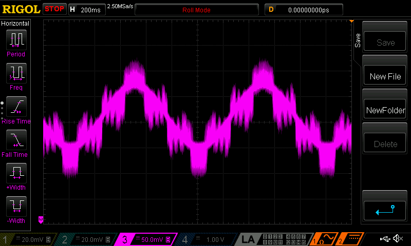

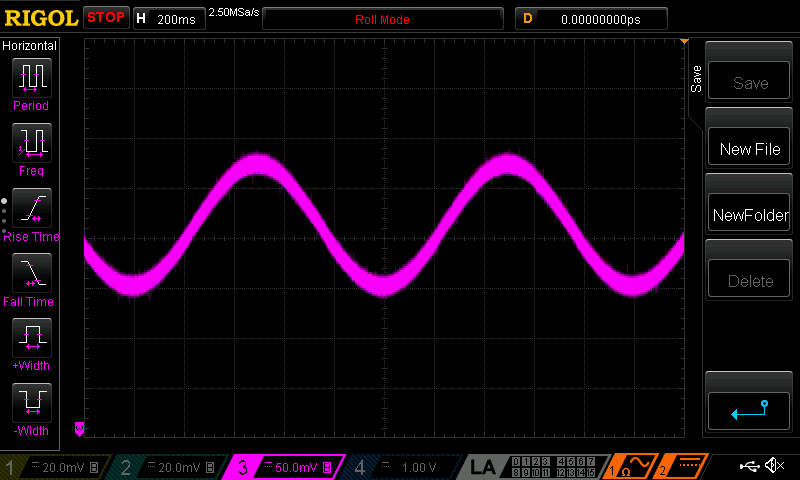

It is clear that "some voltage" is related to values written into ADC calibration register "CLPx."
The left waveform shows the response when CLPx registers of ADC1 are all default values, and right shows when ADC1 was calibrated. They are completely different! Please note that here,  CLPx registers of ADC0 are all zeros as I mentioned at first of first of the series of these posts. From these figures, I can say, we can minimize the distortion by writing all zeros to CLPx registers.
I want to write zeros to CLPx registers, while K22 ADC calibration does not behaves as expected (I think it's a glitch, otherwise please give us an evidence), however, ADC results non-monotonic and/or missing code in this case.

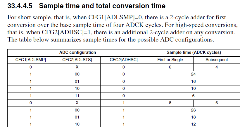

Question 1: According to  section 34.4.4.5 "Sample time and total conversion time" in this document, sampling time should be 10 ADCK cycles, regardless to first or subsequent sampling. What is this 3 extra sampling clocks?
