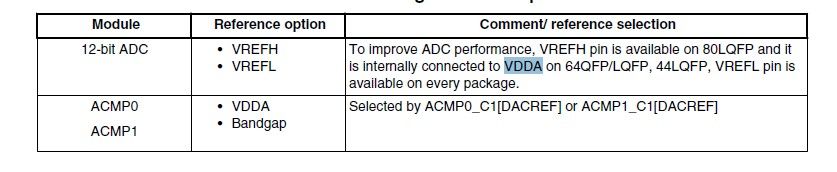

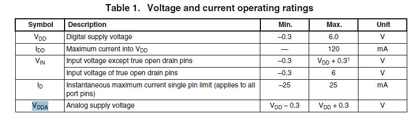

Could you give us your advice on using the ADC within a S9KEAZ128AMLH.
In the 64pin package both VREFH and VDDA share the same pin and from the table below, the limits for VDDA indicate to stay within 0.3V of VDD (VDD is 3.3V)
Erroneously we had connected VDDA/VREFH pin to 1.65V in order to better map the ADC input range to the input signal, and in testing the output data from the ADC appears to function normally and achieved the desired effect.
Can you advice on the implications of supplying 1.65V for VDDA/VREFH rather than the nominal 3.3V.
Does VDDA power/or bias internal circuitry, or is its purpose solely as a reference level for both the ADC/comparator?

Hi Daniel Wax,
   If you are using the 64pin package , I don't think you can connect the VDDA/VREFH pin to 1.65V, just as you list the KEA datasheet picture shows:
   The VDDA should in the range of (VDD-0.3, VDD+0.3), normally, VDDA connect to the VDD.
   So, if you want the VREFH as 1.65V, I suggest you to choose the 80 LQFP package, that package has separated VDDA and VREFH.

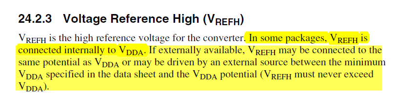

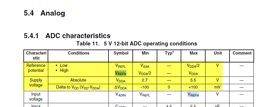

Thanks for the response Kerry.  Yeah I know they are setup outside the datasheet allowances.  And I understand that VREH>than VCCA by more than 0.3v could be damaging but Im not convinced yet that VREH less than VDDA-0.3 is possible to damage anything
The LDO they have feeding VREFH is only consuming 19ma and a reference (table 5.4.2) in the comparator section of the datasheet lists that IDDA (current into VDDA) is in the order of a few tens of uA’s.
If, in (table 5.4.1) VREFH could be connected to 1.65V then why is VDDA limited to 2.7V as this package option has combined the two pins into one.
Perhaps VDDA is used for internal biasing of only the comparator section?
What could possibly get damaged with this wrong setup?  I just need a little more reason to tell them to redesign it.  Thsi part has been shipping in a production vehicle for a couple years and if there is a risk to have the part damaged eventually they need to know about it.

    Yes, VREFH can be connected to the source less than VDDA, from the datasheet, we can know the VREFH range:
    But, please note , the VDD-VDDA can't be largher than +/- 100mV.
The 64 pin package, VDDA and VREFH connected together internally.
So, not the VREFH limit the voltage range, it is VDDA.
