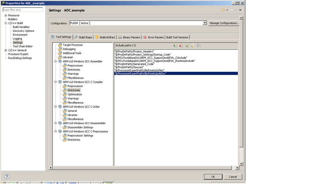

In your code example at the end of that you use the following routine that I cannot find or add, either the include of "PDB_PDD.h":
  PDB_PDD_SoftwareTrigger(PDB0_DEVICE); /* Create SW trigger to start PDB which is selected as trigger source for ADC */

for using the PDB_PDD.h it is necessary to have set correctly the path in the Compiler -> directories: "${ProcessorExpertPath}/lib/Kinetis/pdd/inc"Path settings.png
In the step:   PDB_PDD_SoftwareTrigger(PDB0_DEVICE); /* Create SW trigger to start PDB which is selected as trigger source for ADC */ is written to the bit PDBx_SC[SWTRIG] = 1 which starts the PDB, cause SW trigger is selected as trigger source for PDB in the previous preject. This write is necessary to start project working. You can also choose another trigger for PDB, if you need.
I tryied the project on HW and it works well.
Jiri
