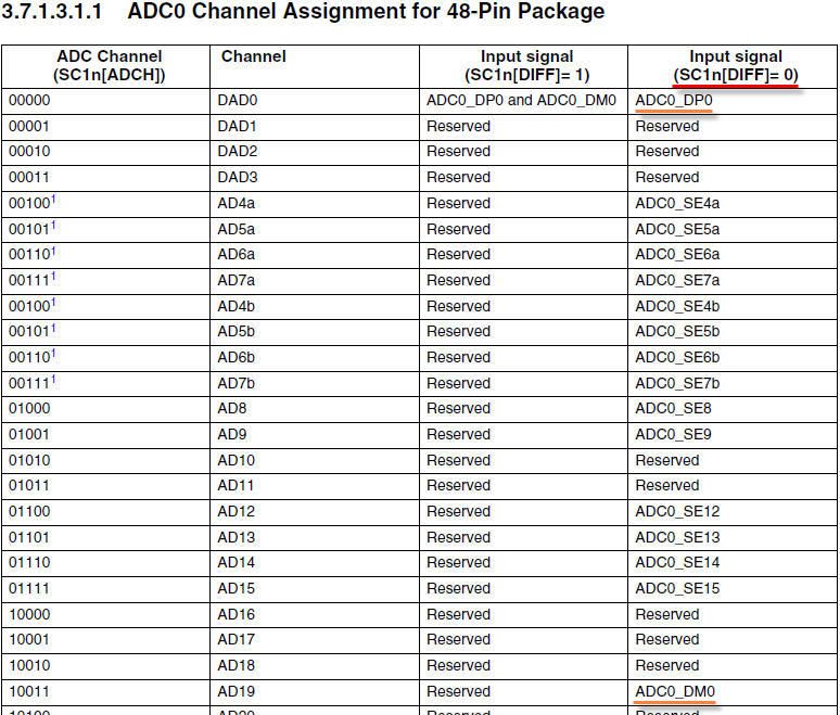

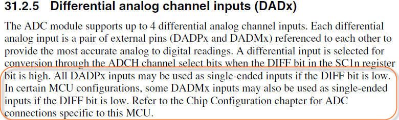

On the K10 48 pin microcontroller, pins 7 and 8 are ADC0_DP0 and ADC0_DM0- differential inputs. We are trying to optimize use of single ended inputs. Is there a way to use these pins for single ended inputs? If we set one of these pins to ground, will the other essential become a single ended input? Is there a way to use both of these pins for single ended input?

There are below describtion in K10P48M50SF0RM:
"All DADPx inputs may be used as single-ended inputs if the DIFF bit is low. In certain MCU configurations, some DADMx inputs may also be used as single-ended inputs if the DIFF bit is low. Refer to the Chip Configuration chapter for ADC connections specific to this MCU."

According to table "3.7.1.3.1.1 ADC0 Channel Assignment for 48-Pin Package" in K10P48M50SF0RM, these inputs are individually valid in 'single-ended' mode, as selections 0 and 19.
