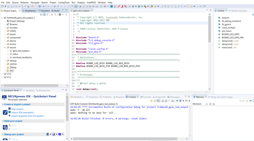

notanivipul
Hi @kerryzhou
Thanks for your reply.
Yes I am using MCUXPresso IDE for frdmkw38 board.
I have attached the screenshots of steps that i am Following, please check if you can find the issues .
Please let me know if you need screenshot of any specific step or any other information.
Thanks and regards
Vipul
38,324 次查看
kerryzhou
Hi notanivipul
  img3.PNG is also from your side?
  That can find the DAPLink CMSIS-DAP.
   If it is not your picture, please just img4.PNG is yours.
   Then, please delete the frdmkw38_gpio_led_output_1 LinkServer Debug.launch, clean the project, and debug it again.
BTW, next time, please use insert photo to insert your picture to the post, instead of attach it, then I can see your question and picture more easily.
Wish it helps you!
If you still have questions about it, please kindly let me know!
Kerry
