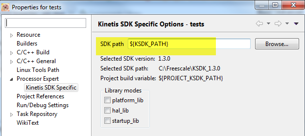

I'd like to set an unique SDK path in the project properties. The problem is I share the project with Windows/Linux developers. Under Linux I have to set the path as shown
while under Windows I have to set the C:/Freescale/KSDK_1.3.0 path.
How can I manage this drawback? I've tried to set a ${variable path} with no success.
regards,
gaston

Hi Gaston.
We can use build variable in SDK path setting, for example:
Please make sure KSDK_PATH is defined in Build Variables
I just tested above on my side, the code run normally with these settings.
Please check if this can also work for you.

gschelotto
Contributor V
Hi Jennie,
The problem is the KSDK_PATH defined in Build Variables is related to the project Properties. If the project of your example above  (with KSDK_PATH set as C:\Freescale\KSDK_1.3.0) is open in a Linux environment it wont work.
An idea is to set the SDK path in Window->Preferences. But where? how?

ZhangJennie
I don't think window preference can have same feature as you mentioned.

gschelotto
Contributor V
Hi Jennie,
In this case It wont be possible to open (without path conflicts) the same project on Windows/Linux indistinctly. Could you confirm there is no workaround to solve it?

ZhangJennie
gaston.
I don't think there is automated conversion option for it.
User needs to modify path setting after porting.

gschelotto
Contributor V
Jennie, thanks for the update. Yes, in fact this is I'm doing right now. Modifying the path for every OS.
