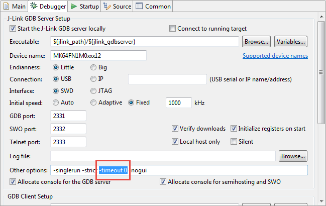

When I build the code, everything works fine and the code gets built properly. When I try to enter debug mode, few times, things work fine and I successfully enter debug mode. But few times i get error -
" Error in services launch sequence
Starting J-Link GDB Server timed out. "
I have attached the image of the error. I have no clue why this error is coming. Please help me.

Hi Vishal,
there is a timeout value you can use for launing the GDB server:
Please try to increase that zero value e.g. to 10, 100 or higher (I believe it it is in ms).
I hope this helps,
Erich

Hello Vishal,
(1) Please check whether here configure right :
(2) Plea create a simple project on KDS ,then debug , have a test , check whether it can work well .
Alice

vishalgirisagar
Hi Alice,
1. I have the setting as you mention it.
2. I have a very simple project just to toggle LED on the board.
I moved from Jlink Segger debugger to PEMicro debug interface and things work fine with this completely.
