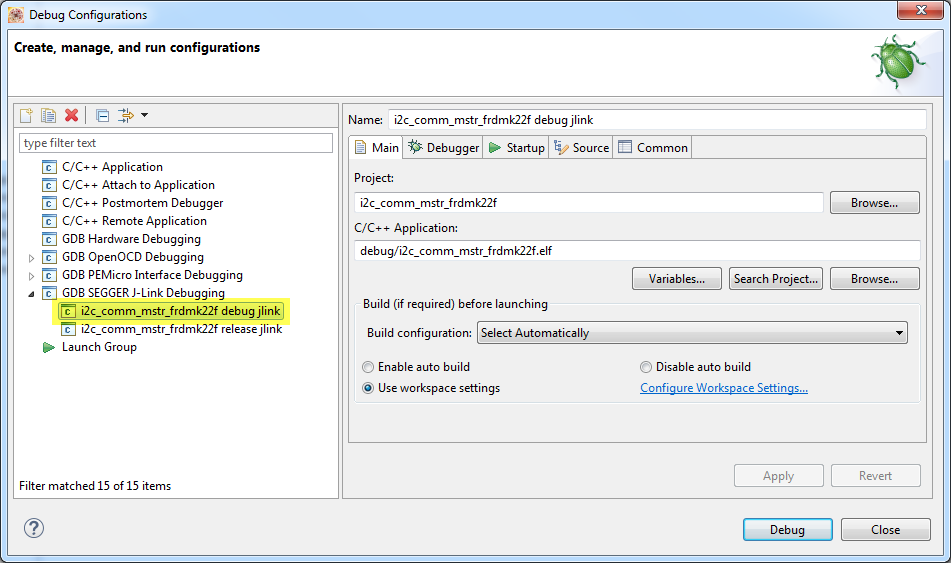

I just installed KDS3.0 and SDK1.3 with demo Freeedom K22F  I went trough and did quick start guide, installing Jlink 2.1 on to OpenSDK,  and sucessfully get terminal program.  so went to Frdm-K22f page, and imported prosample projects into KDS and compile successfully, then go to debug, and get error, "Launching (project name) debug cmsisdap has encountered problem.
An internal error occurred during: "Launching i2c_comm_mstr_frdmk22f debug cmsisdap".
ilg.gnuarmeclipse.debug.gdbjtag.dsf.GnuArmServicesFactory.<init>(Ljava/lang/String;Ljava/lang/String;)V"
this is probably some kind of set up or configuration error in the tool?

Hi Jeff,
If you loaded the JLink OpenSDA firmware to your board then you need to select the "GDB SEGGER J-Link Debugging" connection instead of the OpenOCD connection:
Hope it helps!
