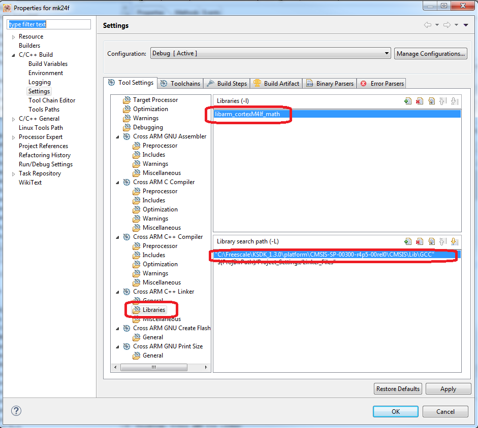

I have been trying to link the CMSIS DSP lib to my MK24F project in KDS version 3.0. I am using KSDK version 1.3.0.
I was so glad to have found the instruction provided in this link Adding CMSIS-DSP Library to a KSDK 2.x project in Kinetis Design Studio. It looked like it should have worked. However, I still have the same error after implemented the steps provided in the pdf file.
c:/freescale/kds_v3/toolchain/bin/../lib/gcc/arm-none-eabi/4.8.4/../../../../arm-none-eabi/bin/ld.exe: cannot find -llibarm_cortexM4lf_math.a
collect2.exe: error: ld returned 1 exit status
makefile:116: recipe for target 'mk24f.elf' failed
make: *** [mk24f.elf] Error 1
I checked the make sure I was using the '/' instead of the '\' and pasted the path in the file explorer to verify that it was correct. Any idea why the ld.exe was not able to find the lib file?

Is you linker pointing to the correct folder where the library is located?
The CMSIS library is in the KSDK path and not the KDS path I think:
C:\Freescale\KSDK_1.3.0\platform\CMSIS\Lib\GCC
David

Here the lib settings in project properties.
The Library search path is "C:\Freescale\KSDK_1.3.0\platform\CMSIS-SP-00300-r4p5-00rel0\CMSIS\Lib\GCC"
The library name is libarm_cortexM4lf_math.

DavidS
Hi Ron,
Try using the name "libarm_cortexM4lf_math".
David

ronyip
Thanks, Dave,
I tried putting "" around the lib name with the same error.
Building target: mk24f.elf
Invoking: Cross ARM C++ Linker
arm-none-eabi-g++ -mcpu=cortex-m4 -mthumb .... -l"libarm_cortexM4lf_math"
makefile:115: recipe for target 'mk24f.elf' failed
make: *** Error 1

DavidS
Hi Ron,
I goofed.  I meant following:
Try using the name "arm_cortexM4lf_math"...without "" and without the prefix "lib".
David

ronyip
Thanks, Dave.
It worked.
