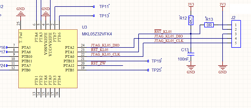

I'd like to flash/debug a KL05Z device using 5 pin (GND, 3V3, DIO, CLK, RST) with J-LINK Base and Kinetis Design Studio v2.0. Could anybody help me?

Hello Gaston,
What is your issue?
- How to do the hardware connection of the pins?
- How to create the debug configuration in KDS?
- How to create a project to flash inside the KL05 using KDS?
Santiago
1,646件の閲覧回数
gschelotto
Contributor V
Hello Santiago,
Sorry for not being so clear.
Here's my current HW configuration
So the question is related to how to create the debug configuration in KDS 2.0 with J-LINK.
