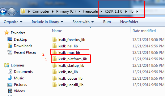

yarannan
So I created a mqx project on KDS and added all libraries, when i built it. It thew me an error:
DescriptionResourcePathLocationType
make: *** No rule to make target `C:/Freescale/KSDK_1.1.0/lib/ksdk_mqx_lib/kds/K60D10/Debug/libksdk_platform_mqx.a', needed by `mqx_tutorial.elf'.  Stop.mqx_tutorialC/C++ Problem
I checked the folder and it doesnt contain the file. Does anybody know what happened?
2,450 Views
Hi Yaran,
Do you want to use the mqx of KSDK ?
If yes,  you need build the two lib :
and if you want to create KSDK-PE project ,  directly create KSDK project , then add the MQX component .
