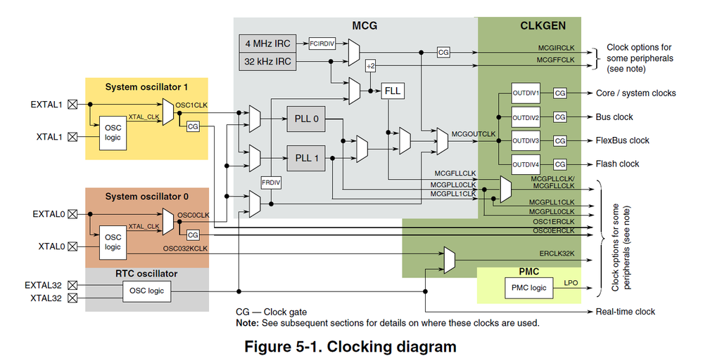

     I did same,but the only problem is PLL configuration,same frequency 120MHZ but some registers are not there in K22.Like MCG_C11,but in that configuration this register is used.what can i do?Is there any another option for PLL configuration.
vanaja.
1,441 次查看
In k60F120m clock configuration,  there are two OSC and two  PLL can choose (OSC0 and OSC1;  pLL0 and PLL 1, ).
when config the clock , it is need to select which of the pathway through this register.
While , k22f120m only have one  PLL, so when use it , directly config it .
So, here ,you can check the project of k60 which PLL it select , ignore the another PLL.    And then config the k22 clock refer to the K60.
You can refer to the Clocking diagram of k60f120m and k22f120m  :
k60:
k22:
Hope it helps
