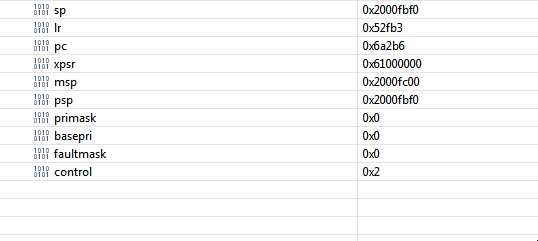

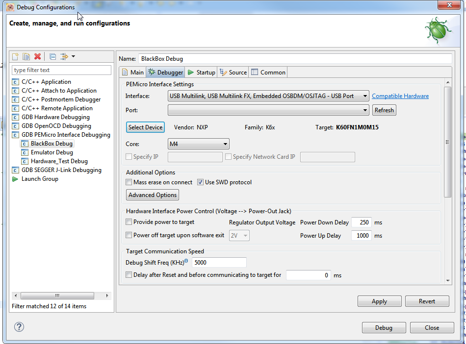

Using K60 CortexM4F.
Kinetis Design Studio 3.2.0
MQX 4.2
523 Views
q7Nhaj
I have the K60FN1M0N15 selected in the debug configuration.
Is there somewhere else the this need to be set.

q7Nhaj
I have no floating point register in display window below control.

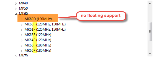

ZhangJennie
hi Jim,
from your screenshot, your K60 part number doesn't support floating register.
please check if your chip part number include "F"
"FPSCR" only shows up when the chip itsefl support floating point.
Jennie Zhang

ZhangJennie
do you mean Floating-point Status and Control Register "FPSCR"?
you can check it in kds debugger "Register" window:
does this answer your question?
