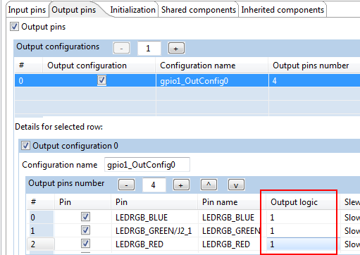

Hello
I try to toggle the pin 10 in portC but don't work.
i tried too with twrk64f100 and i had the same result! don't work.
any idea..
Thank you and regards.
Loris

Hi Loris,
A couple thinks are happening with this particular signal.
First....make sure the schematic you have matches the revision of the FRDM-K64F board as the PTC10 and PTC11 were swapped at the J4 connector.  so your code might be working but on wrong pin!
Second, your fsl_gpio Output configuration for the pin has it defined as Open Drain.  On the FRDM-K64F there is not pull-up enabled on the port pin or externally so it will not toggle.  Enabling the pull-up or adding external pull-up will allow it to work.
Third, change the pin configuration to non Open drain and you should see K64 toggle pin.
David

Hello Loris,
The function of  "GPIO_DRV_SetPinOutput(LEDRGB_RED);"  is set the pin of PTB22  to "1" ,
while from the SCH we can see , if  want the light up the RED led , please configure the pin to "0":  GPIO_DRV_ClearPinOutput(LEDRGB_BLUE);
And when you configure the three LED to 0 , the colour is white , so  i recommend  you when want light up (clear to 0) blue , please take off (set to 1)the other led.
And in your fsl_gpio configuration , in the "output logic" , you have configure all of them to "0", i think you can cogfigure it to 1, and it meaning at the begin ,
all of them are off.
Hope it helps
